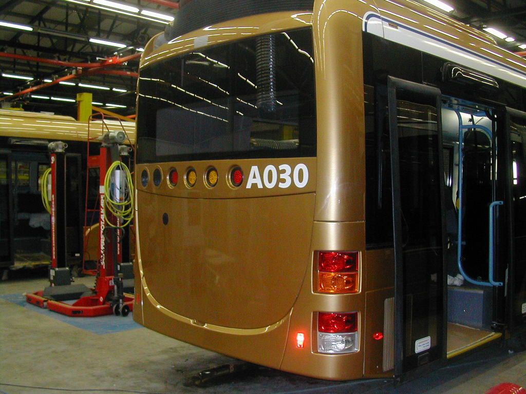

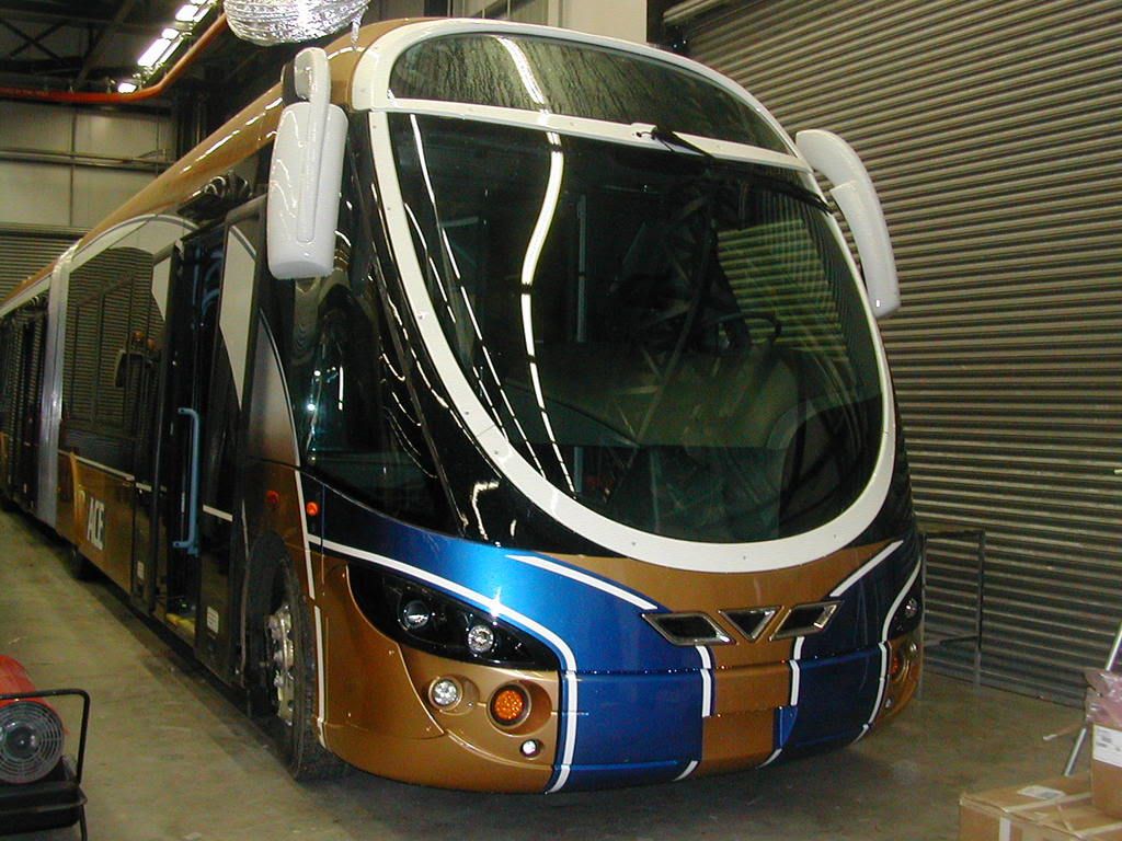

heres a couple of pics of our latest bus.Entire front and rear ends and most of the sides are composite.Roofs are alloy but we are currently looking at changing that to frp as well to save more weight and cut down on cost.
Now that’s a cool lookin’ bus! Think they would like to sponsor my funny car team…We’d sure look good in that trick lookin’ bus!
Now that’s no mop and bucket Polyester job, what kind of materials and process do you use there?
i would love to see your molds for them too!!
Some of the parts are hand laid or chop gun,some are rtm.
Depends on how complex the parts are.The larger parts have core materials of various types.These buses are for las vegas.I will try to get some pics of the various molds
