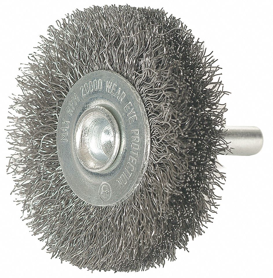

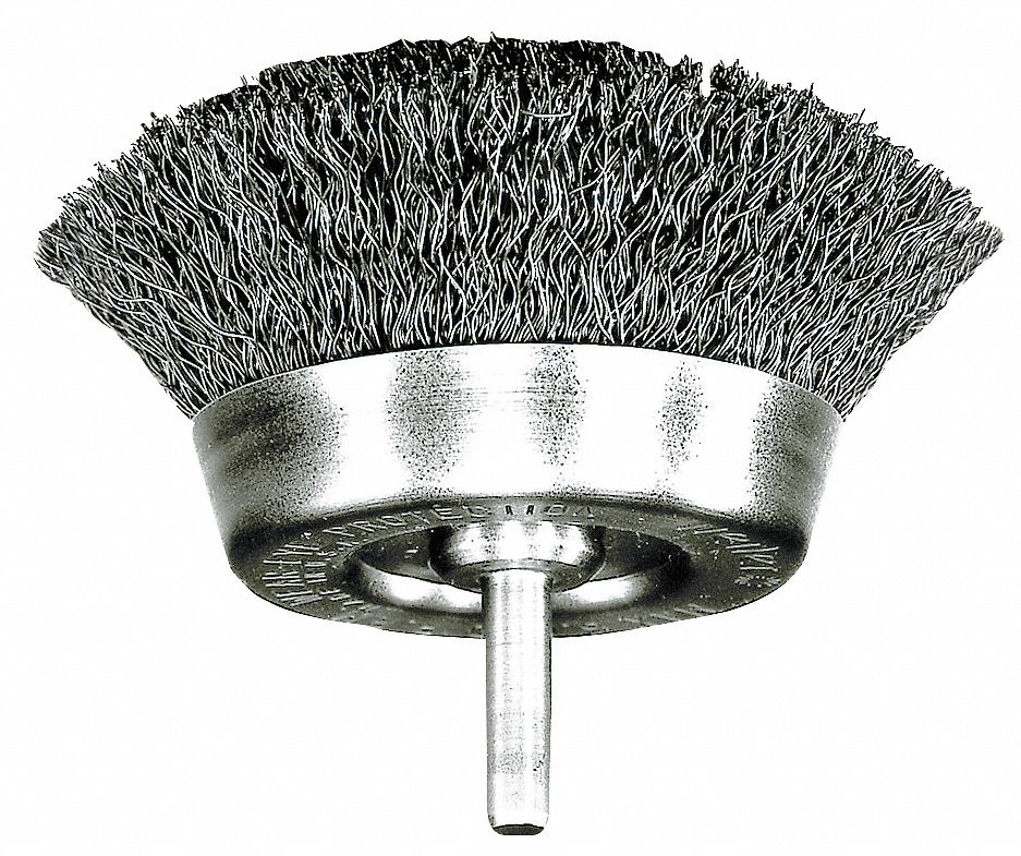

Sometimes I’ll scuff up a piece with a wire-wheel/cup brush on a drill…haven’t had any de-lamination issues yet. There are several styles that I have used…
