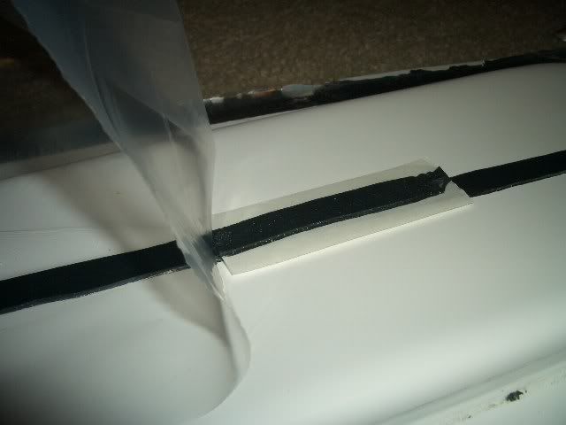

right,ive tried it and i think i got it correct.ii took some pics so you can confirm i did it right and also to help other people who find this post on the search
main tape laid all around mold edge-
film laid halfway along one side and 60mm extra strip of tape added-
film laid over extra strip and lifted upright-
film folded over the extra strip
backing tape removed from the extra strip and film continued along mold-
Man that sure is one way to go about making a pleat.
