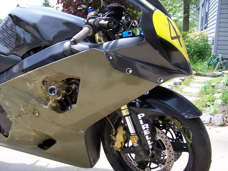

For FZ1gpt
Any chance (if you haven’t already) you can take us through what you did to the fuel tank on the bike in the picture please? I did a search and noticed you mentioned an overlay on the tank of your race bike. Is this the same one? If possible could you post some more pictures of it please?
FZ1Pilot… that lowside incident picture looks like it bent a frame/engine mount? Did your helmet pick up as much grass :smiley:
Very nice bike and composites btw :slight_smile:

FZ’s tank is an overlay.
Building a complete tank is a bastard that even I dont want anything to do with yet.
CSM will work with epoxy resin systems, but you must use powder bound CSM, rather than what is generally suppled for use with poly resin systems.
LOL I’m still finding blades of grass.
The tank on that bike is a overlay and not a very good one (was my first), used the normal overlay process, lay on resin let it tack up then apply the fabric followed by more resin. There are a number of posts on overlays.
