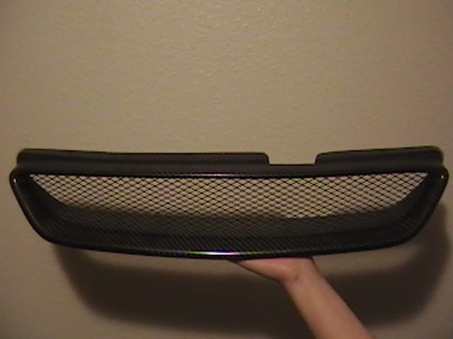

any idea(s) how to make this overlay easier?
this is what I am overlaying in carbon except it is made of abs plastic
does anyone have advice on making this easier for me to lay the fabric down nicely
I am confident that I can do a good job reguardless but wouldnt mind some insight from others :cool:
thanks in advance =)
Hmm i haven’t overlayed a car part like that, but I would say if you can remove the mesh grill it would make it much easier to overlay the part.
oops I forgot there is no mesh grill
With ABS you have to use epoxy resin as PER will melt it!
yep I am aware of that. I suppose allot of clay and some seran might be my friend here?
annother thing I was thinking was to make releif cuts though I have never been a big fan of the end results.
