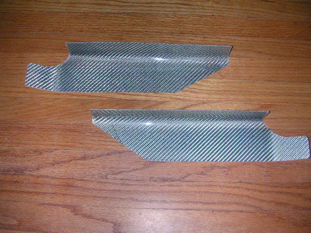

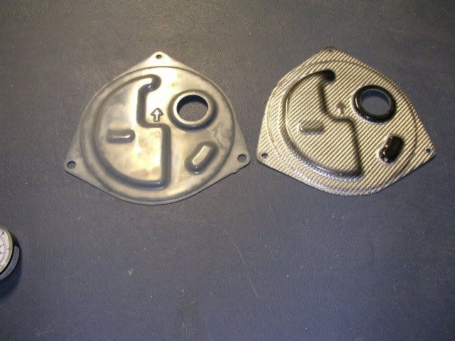

Pics of some small Texlium parts we’ve made:
