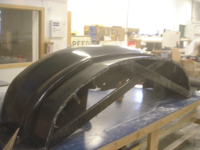

suggestions for a flange for this part?

if the back is flat, i generally lay the part on a sheet of wood and use clay to mold it into the board, wax the whole thing, build my mold with as big of flanges as i need, then afterwards everything comes apart…
What high temp system did you use? Who distributes it?
huntsman gelcoat and epoxy. northern fiberglass. www.nfgsales.com

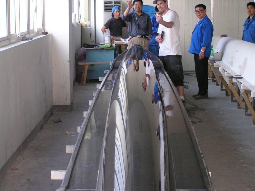

here are some pics of some other mdf flanges I have made:
lots of polishing.

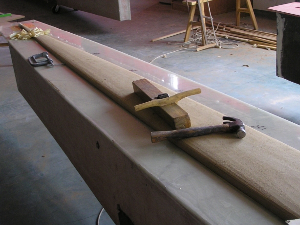

heres another example of a mdf flange I did:
