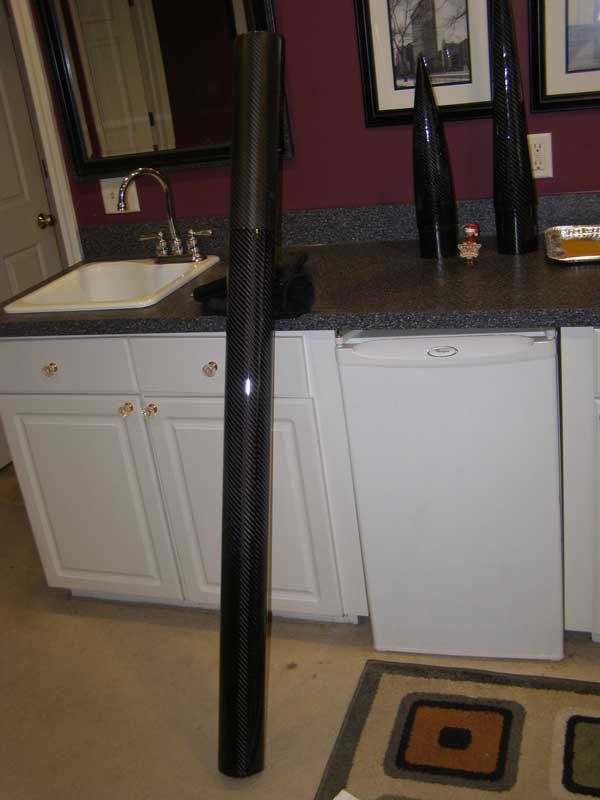

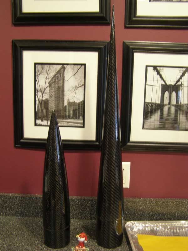

Heres another pic of the press when its broke down and a couple other rocket parts.
The fins are a 1/8" styro core and two layers of 4x4 twill on each side.

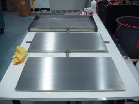

Thanks a million guys for trying to help. I really wanted to come up with a cheaper version of the press I posted. Oh well.
