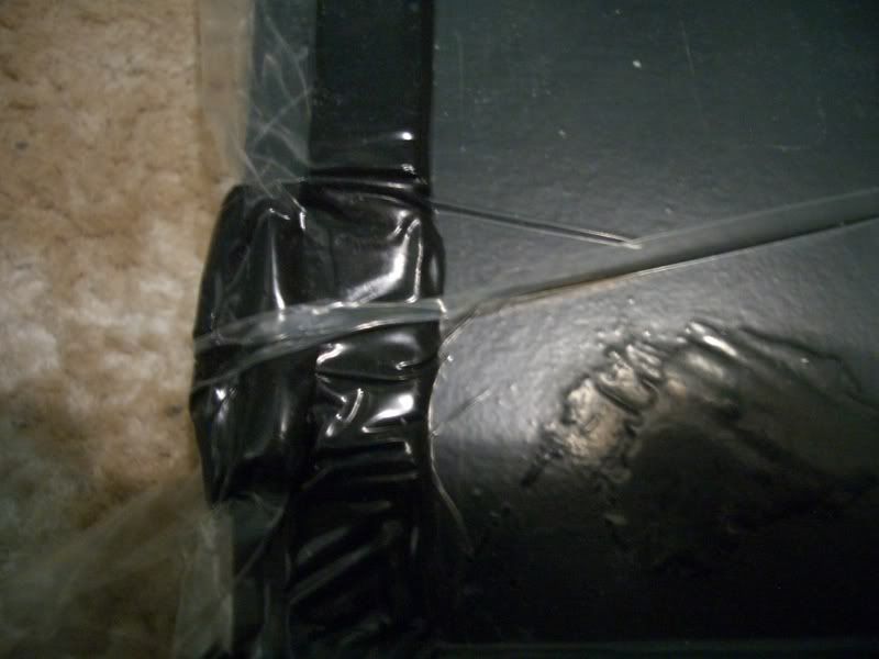

do you mean like this but with film over the top obviously? sorry about the crap picture,camera has gone flat.
yes m8 exactly.
Baz

And the pic of ‘straws’ in the sealant tape…thats a no-no.
If there is a hole in the bag that you find, just put a piece is takcy tape on top of the bag to seal it. It wont mark through.
Bill, if you are refering to gtfours pic above its not a straw m8 it`s 12mm plastic hose, that hose is to draw the vacuum, nothing wrong with that, works just fine. I sometimes use that method amongst others and never had a problem.
