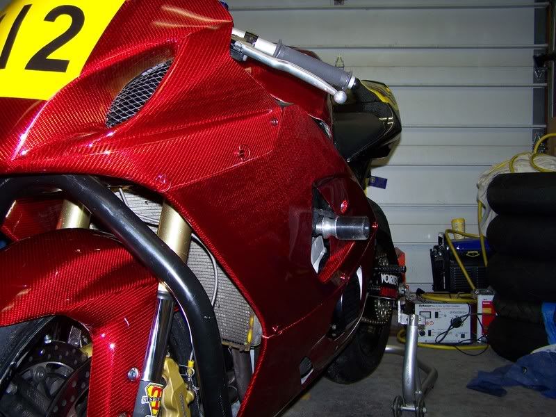

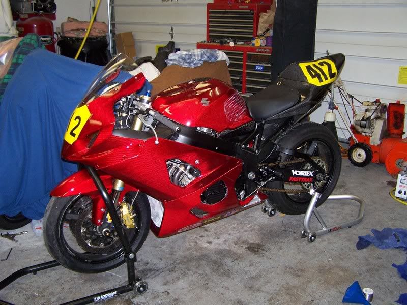

Very very nice work. You did an awesome job with the rattle cans. It’s not easy to achieve such a nice finish with a rattle can. I love the look. If someone else wants to copy it using an hvlp, let me know. I can get you the paint brand and color. It’s probably a kandy concentrate mixed in with clearcoat. HOK and many others make Kandy colors that are either directly sprayable once mixed with the catalyst, or they can be mixed in a clear coat urethane.
Looks very hot.
Most times if paint is going over plastic ( resin is plastic )and you have sanded the substrate, no adhesion promotor is needed. Mainly adhesion promotor is for brand new plastic parts and you want to save time by not doing any sanding…
new bumper cover for a ford or bmw, any make.
Wash the bumper cover with auto body solvent wash.
Spray Bulldog or similar adhesion promotor.
primer the part, finish sand primer with 400-500 grit paper, clean again, then paint. Body shops are usually the ones using adhesion promotor. No big deal really, was just an extra step you took.

I was just not sure how the paint was going to react so I used the bulldog adhesion promoter.

Are you making all these GSXR fairings from the same set of molds? What do your molds look like and what are they made of? The parts your producing look great.

They are from the same molds, I use the gel coat as a sanding layer to even out the part. Normal tooling gelcoat and FG mat molds, I dont make very good ones but they work.

so let me get this right…to get that result - you mixed a red candy with clear coat and sprayed it over normal black carbon fiber yes?
