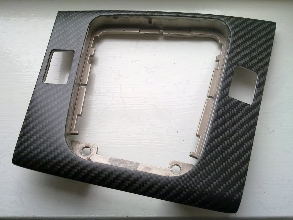

i finished the test piece,obviously needs a final buff here but not too bad…one problem is that when i sanded all the paint off the abs was white,i used a black dye in my base resin coat but looks like i should have used two as you can see white patches coming thru the weave in a couple of spots…but overall its ok for a test bit.

It looks like a very nice looking piece. What do you use to cut the edges? It’s very clean.

i used a dremel,VERY carefully! followed by a sanding block…

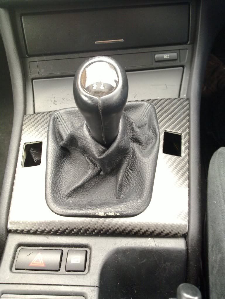

i tried it in my car,its not the proper one for my car hence it being a scrap test bit before i do the proper one…

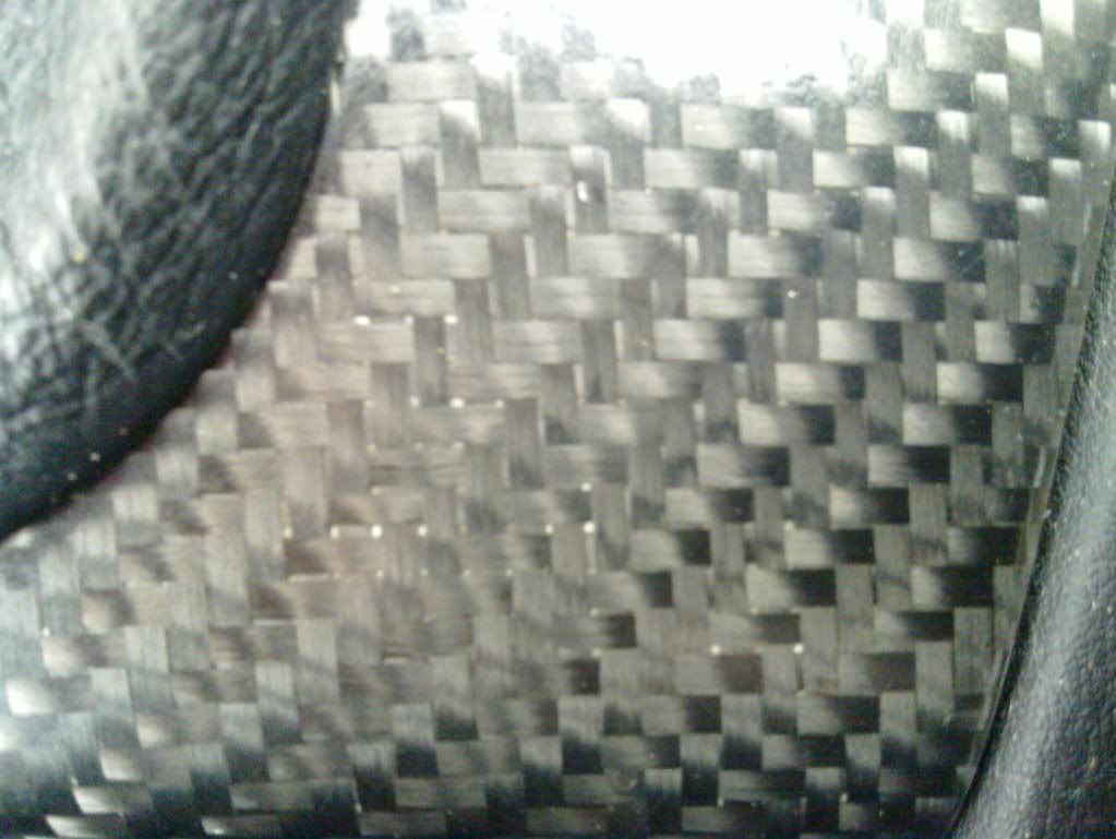

here is the white showing thru the weave,how should i prevent this next time?? i used black dye in the resin but it didnt coat very well,maybe 2 coats or even a layer of fibreglass tissue??
More black resin. Before you lay up paint the part black until you can’t see white anymore and then layup on it. Or you could try another layer of CF which will reduce the chance of white showing up on the background

Maybe you could try finding a black paint that will stick well to both the plastic and epoxy?.. maybe a thin layer of black gel coat? Just an idea.
