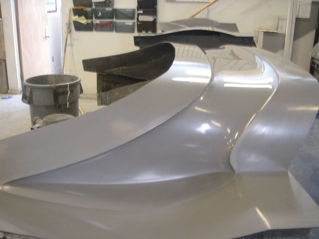

LOL that was some funny stuff. I do wish someone would show me a picture of a mould they just pulled using PVA only. I am interested in seeing the mold detail and see how it compares to a semi mold. Any takers?
sure, heres a mold I made with semi, no pva…
thats perfect…
